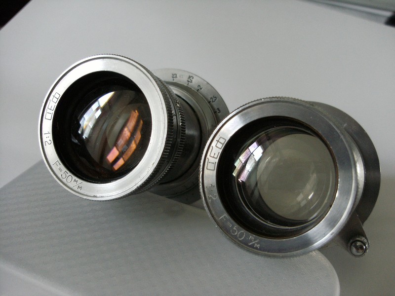

Yesterday, I received one of the last 2/50 produced, as far as I know: the serial # 32649 (to put on my 180xxx S eBerdsk). I was surprised by the first lens which shows blue/lilac reflects which don't exist on my six other 2/50 Fed lenses, as if this one was single coated.
My question of course, is: is it possible? When?

No doubt this is a Fed lens! I checked its optical possibilities: it is completely out on the complete range, as Stephan says. It's easy to compare roughly two identical lenses. This one was certainly dismantled to be repaired, and the different optic groups of lenses were badly re-mounted.
All that doesn't explain the apparent coated lens... To my mind, it's the point which could be interesting. And the specialized books don't give any explanation.

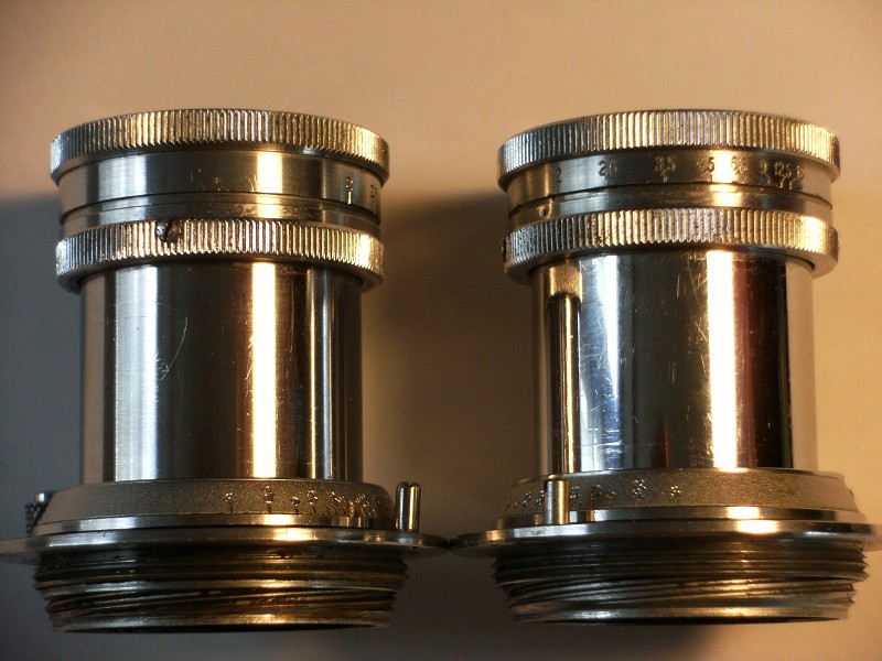

I have just partially dismantled that lens and compared it with another 2/50 lens I own: the n° 27957. The two rear units are identical: same aspect, same convergence. It's not the case of the front part. The 32649 is globally much more convergent. The very front lens seems more curved and thicker (I took it away), so that the ring cannot be screwed completely in the barrel to fix this lens. It's this first unit which is coated.
Of course, impossible to take pictures with this lens mounted on a Fed S or any LTM. Perhaps the work of a handyman to sell its lens? Or a trial of the factory for an hypothetic 39mm small format in 1941 or after WW2...?
Amitiés . Jacques. |

As the ring cannot be completely screwed to secure the very first lens, there are two millimeters which protrude. And the screwing aluminium cover is exactly 2 millimeters larger than the ordinary one to enclose all that. The work is perfect. I try to join a picture.
So that is hardly noticeable that the lens 32649 is very slightly larger than the 27957.
All that makes me think this lens was made by the factory. But when? And above all , why? If you have ideas...

Posted - Aug 09 2008 : 07:52:00 AM
It has worked! So, one picture more which shows the faint coating of the left lens and the convergence of its very first lens (the diaphragms are wide open on the two!!).
Jacques. http://www.ussrphoto.com/UserContent/fed objectif 003.jpg
