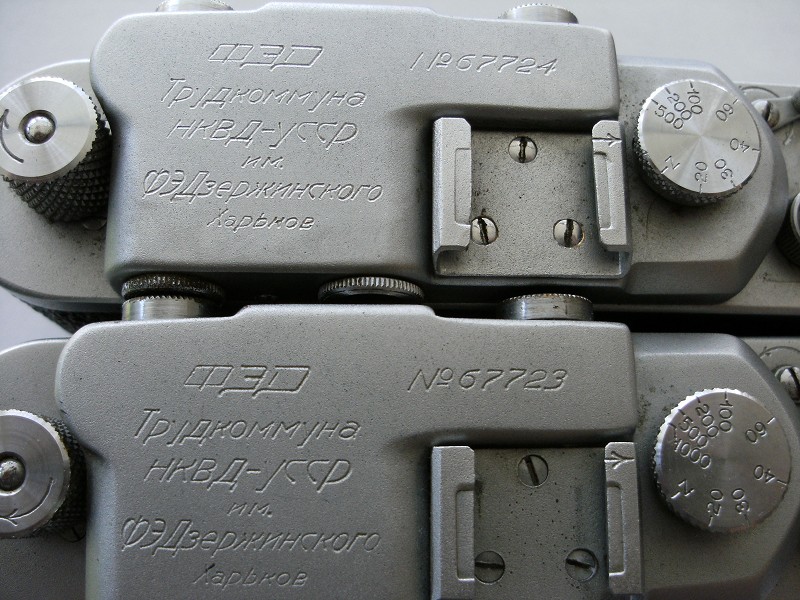

Hello!
I have owned the S for several years.
But the simple NKVD is a recent discovery.
A miracle ?
http://www.ussrphoto.com/UserContent/2462009_Consecutive Fed 002.jpg
Posted - Jun 24 2009 :  08:45:11 AM  Show Profile  Visit Vlad's Homepage  Reply with Quote
Hello Jacques!
Amazing!!!!! I never thought I'd see this day but it did happen!! Congratulations! Now we need to find the #67722 to see whether FED-S production was sustained in groups or was just randomly picked regular model and modified.
2669 Posts
Posted - Jun 24 2009 :  09:20:13 AM  Show Profile  Reply with Quote
Hi Vlad!
It can take several centuries to find the # 67722!
Anyway, these two cameras were certainly engraved with the same machine tool using the same regulatings: the second "7" is slightly upwards on both.
But the clip is no exactly the same. Perhaps made outside?
zhang

Congtratulations, truly astounding!!! I think that now we will all be looking through our Fed-1 cameras in the search for 67722, and 67725

it's fantastic, my best congratulations!!! It was my old dream to have a pair of cameras with consecutive numbers indeed You've made my dream into reality, BRAVO!

To be honest, I didn't really look for cameras with consecutive numbers: I thought it was impossible.
And when I saw this serial # 66724, I first thought it was not unknown to me. And after having checked my other NKVDs....
But it's only hazard: what are the chances to get such a couple when there are about 128000 NKVDs (1c to 1e) and 13000 S among them?
Merci, Aidas! It's marvelous to share such dreams!
