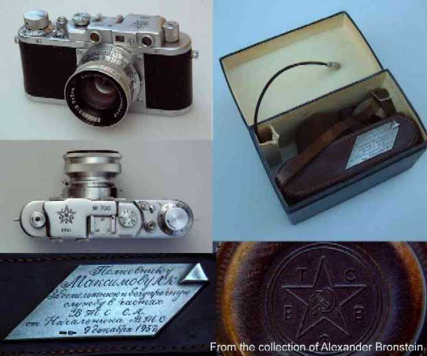

Here are some other TSVVS cases, including one from Alexander Bronstein that has an engraved plaque on it! The first photo is one of my cameras.
http://www.ussrphoto.com/UserContent/TSVVS1.jpg
http://www.ussrphoto.com/UserContent/TSVVS-700 Bronstein.jpg
http://www.ussrphoto.com/UserContent/tsvvs_case.jpg
947 Posts
Posted - Sep 10 2008 :  03:33:16 AM  Show Profile  Reply with Quote
Very interesting!
Could somebody translate what is said on this plaque? Thanks!
3294 Posts
Posted - Sep 10 2008 :  9:58:42 PM  Show Profile  Visit Vlad's Homepage  Reply with Quote
Jacques, I would be happy to translate it, but it's too small and fuzzy.. Bill, is there a better image by any chance?
3294 Posts
Posted - Sep 10 2008 :  10:05:14 PM  Show Profile  Visit Vlad's Homepage  Reply with Quote
OK, I blew it up in Photoshop and whatever I could make out says "To Colonel Maksimov for [something something, probably good]service in VTS (Voyenno Transportnih Sluzhb - Military Transport Services, I would assume or Technical Services) from the chief of VTS, December something, 1957"...

Also he wrote me about Alexander Bronstein's camera that says to "Colonel Maksimov A.K. for long and exemplary military service in divisions VTS S.A. from head of VTS".
But I think we already talked about that, VTS is Miltary Topographical Service and S.A. is Soviet Army.

On Steve's camera when you open a bottom plate it has a little "8" stamped into the bottom of shutter assembly.

1. The number 8 is located as Vlad described, in the body as well as centered under the film spacing bar of the baseplate.

Here you can see close-up photos of the impressed number (in this case "63" that Milos was talking about, on one of my TSVVS ( No. 577).
On the bottom plate:
http://www.ussrphoto.com/UserContent/2642010_TSVVS21.jpg
On the bottom of the shutter cage assembly:
http://www.ussrphoto.com/UserContent/2642010_TSVVS22.jpg
Here you can see those and other close-ups of the same camera (click on photos to enlarge):
http://www.nightphoto.com/TSVVS.html

I am extremely happy to say I have also received an email from Dr. Milos Mladek with some pictures and very interesting information!
Here it is, the pictures follow:
it is of course tempting to draw some conclusions from the fact that the TSVVS is a very well made camera, unexpectedly well made for a Soviet camera, but I do not think that it was indeed German (Zeiss) or Japanese. I still consider the TSVVS a Soviet camera.
The history of Carl Zeiss Jena, prewar, wartime and postwar, is very well documented. There still are witnesses of the time from the factory, and as there never was a policy of secrecy in Germany comparable to the veil of secrets that covered all important things in the Soviet Union, the details of camera and lens design, patents, manufacturing data and sales are well documented and accessable.
Zeiss Historica merits all our thanks in this connection. If Zeiss really had made the TSVVS it would not have been possible to keep it secret, at least nowadays. Even the most minute details of camera and lens design history are now common knowledge among Zeiss enthusiasts. The eye witnesses would have talked about it, as they have given interviews to Larry, who unveiled the details of the Jena Contax history talking with the men who built it. Yes, there were some who were displaced to Krasnogorsk and to Kiev, but in most cases finally they returend to Germany and were able to report what they had done and experienced. I find it completely unlikely that such a well designed camera would have been manufactured secretly in Germany completely without leaving traces. Unthinkable.
The TSVVS is a very special camera. I have been admiring the TSVVS from the first moment I saw pictures of it. It must have been about 20 years ago, after the breakdown of the Iron Curtain, or slightly earlier, when the first examples of this uncommon camera were offered in a German auction house. They were exotic, not very high- priced, rather moderate, and we European collectors did not know what to think about them (oh, had I bought them!). And of course no one of us here in Austria had ever seen this hybrid of a Leica-shaped body and a Contax-inspired mount ever before, despite the fact that Soviet photo gear was definitely common here: Mashpriborintorg had a contract with the biggest foto dealer here, Foto Niedermeyer, for at least about thirty years, and they sold a big many of photo stuff from Lubitel over Smena, Zorki 4 and Kiev to the various Zenits and the Sputnik. Only the Leningrad (the most expensive of them all) was never sold here officially.
Then, in the second half of the 1990s, some examples of this rare beast turned up here in Vienna, and I was able to buy some of the most beautiful. I was able to see about two dozens of them, examine them, repair two of them (most are completely functional - the repairs were necessary because of mistreatment only). I agree with Vlad that the TSVVS is really very well made, and if you take one in your hand you feel a feeling of worthy craftmanship, of value, of precision. By the
way: if you have ever had a TSVVS in your hands you will never mix it up with a TSVVS forgery based on a FED (quite in contrary to some statement I have read in some forums years ago where someone questioned that something like a true TSVVS really existed - he considered them all forgeries, which of course is nonsense. Once you have got familiar with this great camera you can tell it from a distance (even from a small photograph) whether it is a forgery or not. It is outstanding in every detail and cannot be mixed up. Repicating all details would surmount the possibilities of even the most skilled forger precision mechanic.
The camera design details, yet, are also quite unique, and show no relations with any major brand like Leica, Nikon or Contax. An
example: Did you all notice that the built-in helicoid, while very inspired by the Contax Helicoid, is in fact totally different? If you turn a Contax lens (be it a Dredsen Contax from the 1930s or its replica, a Jena Contax from the late 1940s) from infinity to 0,9m it will take you a turn of 280 degrees, while in a TSVVS (even in the better of the forged examples) it will only require a turn of 190 degrees. This is a whole world! Even if there were the outer bayonet lugs to mount it, a tele lens would never focus properly on a TSVVS. It is highly unlikely that a workshop even if only distantly related to Zeiss Ikon would so to say invent the Contax bayonet a second timeworsening the original!
Not to speak of the Japanese, who copied the Contax mount in a much better way. There are also other details on the mount that make a relation with Zeiss unlikely. The clip that holds the lens in its place is a mass-produced part, and no one with access to such a part would dare to redesign it in a way so that it costs manyfold the money of the original, with no noticeable advantage. But that is what the TSVVS manufacturers did. The original clip of the TSVVS is different to that of any Contax (from I to IIIa), it is made of fragile, thin sheet metal and has a riffled little knoblet riveted to its end. Regrettably enough this part has been broken in nearly each and every example of the TSVVS. You can see the shape of the original in the attached pictures.
And: even if the manufacturers would have tried to mount a Contax clip on their lens helicoid, this would not have worked. The distance of the two screws that hold the clip in place is different from Contax to TSVVS (the screws are about 0,7mm farther apart in the TSVVS which means that you have to enlarge one of the holes in a Contax clip to mount it to a TSVVS - this modification can be seen in nearly every TSVVS). Can one believe that anybody manufacturing a camera with a Contax inspired mount who has access to the mass produced lens retaining clips would refuse to use them, unless for some special reason, total autonomy of manufacture, for instance?
In the course of the decades we all have developed some gut feeling of an unnamed cameras origin. And my guts tell me that the TSVVS is indeed Soviet. Let me tell you some few further details, why I think so.
Look at the screws. They are definitely bigger than you would expect in a German camera (not to speak of a Japanese camera!). And they are somewhat roughly made, very very slightly differing an size and the shape of its heads from piece to piece. The cut in the heads of a TSVVS screw is not always in the exact middle of the head. Yes, in an early FED all these characteristics are far, far more obvious. But if you keenly look for such small things with a magnifying glass, you see them. That does not mean that the TSVVS is crudely made - but it is different in a way from a German camera that I exclude a German manufacture. In a Viennese camera, by the way, things would be different (think of the a Wica, the world record holder in crudeness - but I love it . . . ). But the German camera industry got screws from specialised screw manufacturers, they did not make them on their own (I do not speak of the Pentacon years - then they more or less manufactured all in their own house, beginning from the screws, I speak of the years before). Precision screws in Germany always were a mass product of highest precision, and the TSVVS screws to me look like very well made domestic-made screws, with some strength- reserves against over-tightening.
You see, a simple camera, and so many different opinions on it. Here we say: ask three doctors, and you will get four opinions. Mine you have got now, and I am looking forward to the day when we all will learn "All trust on the TSVVS" as our collectors colleague Yuri Davidenko calls it. Or the whole prawda.
O.k., If I would have to the bet, I would probably bet that Yuri is right.
The story he tells us is so nice, that I like it.
But the day of the whole prawda will come!
Best greetings from Vienna, Milos
http://www.ussrphoto.com/UserContent/2642010_TSVVS 1.jpg
http://www.ussrphoto.com/UserContent/2642010_TSVVS 2.jpg
http://www.ussrphoto.com/UserContent/2642010_TSVVS 3.jpg
