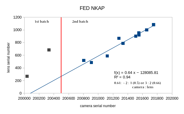

Interestingly the new pairing fits way better into my regression line. It is an excellent fit with a R² of 0,94 (1 is max).
What we see here are 13 pairs of FED NKAP cameras with a 4-digit #0XXX lens. One from Jacques was omitted as he states the pairing is not original and a macro lens.
For the 2nd NKAP batch from about #200.500 onward these lenses apparently were paired with cameras in a specific way.
We would expect camera serials to start at 200.000 and lens serials at 1 and then roughly rise 1:1. For every camera serial the lens serial rises per one on average with more or less equal outliers grouping left and right as they poured together batches of cameras and lenses.
But obviously this cannot be true as quite some Red Flag cameras come with different lenses.
Now while the 13 cam-lens pairs with reasonable 3-4digit numbers group very well along a regression line pretty much like with the FED-S, things do not work as expected. Apparently it takes more than one camera serial numbers for the lens serial number to rise by one!
The blue line is the calculated regression for our samples - with a slope of 0.64 it lies between 2:1 and 3:2. Assuming 2:1, camera serial rises 200, lens serial rises only 100. Clearly these lenses were not paired randomly with cameras.
But this only works for the 2nd NKAP batch with sharp-edged top plates and shiny chrome from around #200.500 onward. There are only two samples for the first batch and they are unusually high lens serial numbers for these early cameras. Curiously the regression line pretty much hits zero on both axes, so if we moved back to camera #200.000 in this pairing scheme of batch2 we would theoretically arrive at lens #0001. But in the real world, the 'primitive' batch1 with the blunt edged top plate and dull chrome up to about #200.500 behaves differently.

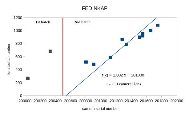

Alternative hypothesis:
The lens:camera serial ratio for 2nd batch is indeed roughly 1:1 and we are just seeing a lot of outliers.
Things would look like this.
Impossible? Certainly not. Maybe the ratio was unstable an the beginning and flattened out towards the end. We saw something similar in FED-S'c'. Curiously this way the regression line reaches zero (or the hypothetical lens #0001) close to #200.500 where we expect the 2nd batch to start. This however excludes this lens type from the first batch meaning the two samples we see there are not original. Not improbable.
We only have 13 samples out of about 2000 produced Red Flag cameras, that's 0.65%
For the 2nd batch, omitting the beginning, 10 samples out of about 1000 which is 1% and not bad for such statistics. And these 10 form a pretty straight line to me.
