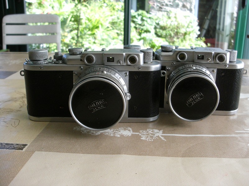

My cameras are from 1949 (serial # 264)and 1950 (# 503). They both have postwar 2/5cm Sonnar lenses, T coated and made at Jena. Some rare first 1949 TSVVS were supplied with prewar 1,5/5cm uncoated Sonnars (all in the 226xxxx range by the wiki). Curious.
The two lenscaps read "Carl Zeiss Jena". They are very probably original: all the other caps mounted on lenses of the same period (for example on Jena Contaxes) are not black, but silvered. Lenscaps which read TSVVS (always black) are mounted on later 1950 cameras, as it seems. Alain Berry's 1950 TSVVS had such a cap (serial # 781).

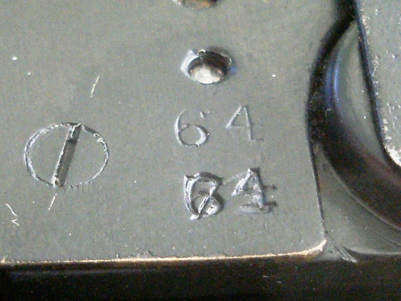

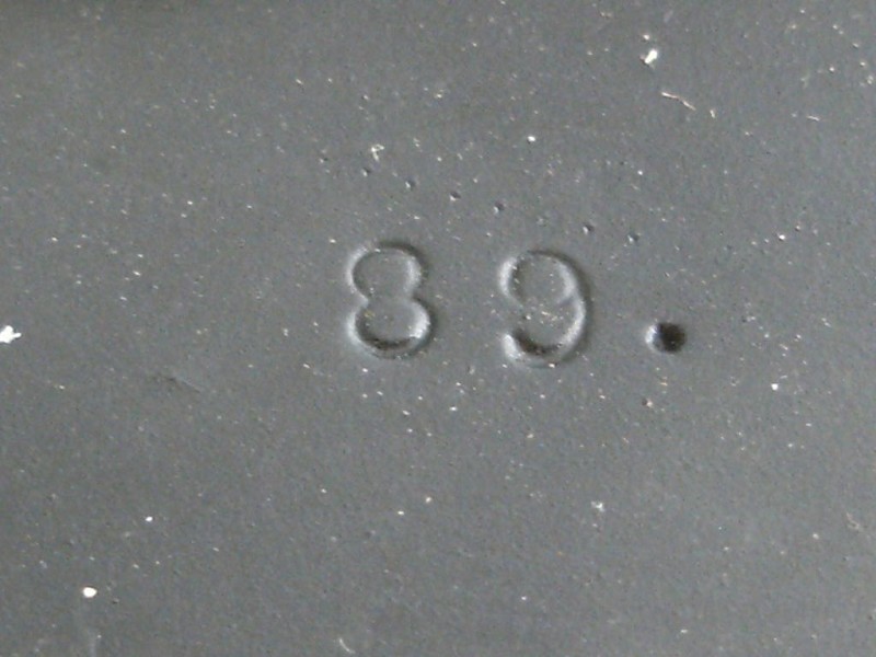

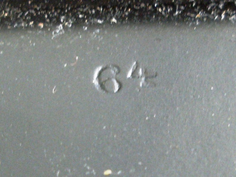

The internal numbers are a mystery.
This number (the same for one camera, most of the time) is struck
- on the baseplate (inside),
- on the corner of the shutterbox,
- on the back, behind the filmplate, by DVD Technik. But I did not checked...
I thought first that the number was a "short" for the official serial number: my # 264 has "64" inside!
But my TSVVS # 503 has "89" as internal number:
Concerning the "64" inscription, the reengraving on the shutterbox is interesting. One hypothesis: this number could be the factory mark of the perfect adaptation for the three parts of the camera: back, bottom and shutterbox. On my # 264, the original shutterbox had to be replaced, a new one adapted which needed a reengraving.
Of course, other hypothesis are possible. Anyway, there were some 1000 samples of TSVVS, and this internal number only has two ciphers...

The viewfinder/rangefinder of my TSVVS is very neat. Much more than the one of contempory Fed, for example. Probably the quality of the construction.
But just a question. When I look through the rangefinder, the central spot only is yellow on my # 503, the rest is transparent. On my # 264, the central spot is pale yellow, the rest is dark yellow (if yellow can be dark!).
Difference in the mounting? Repair? What about yours?

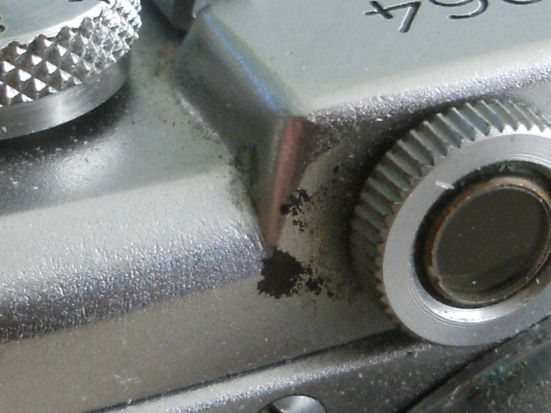

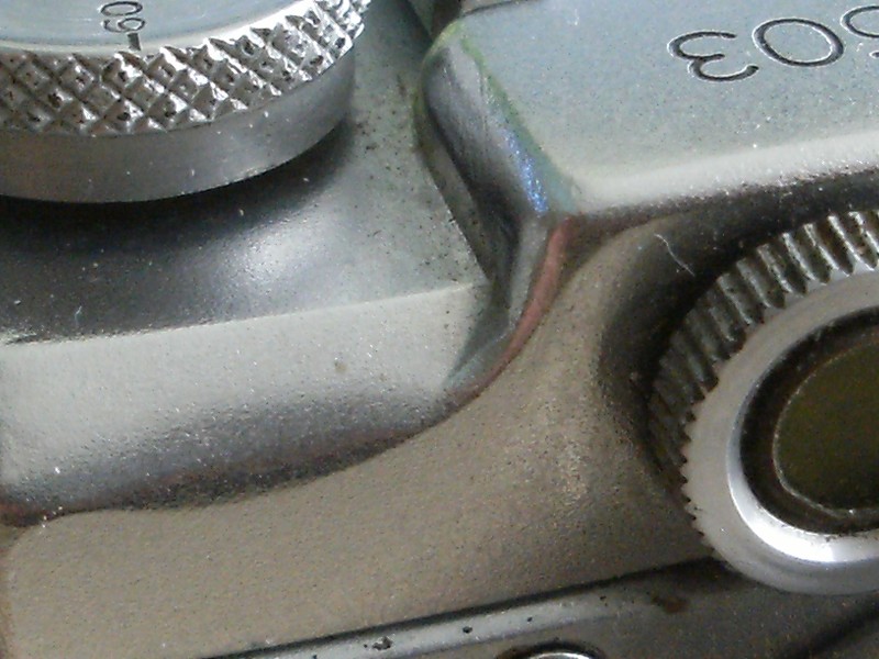

About metallurgy, a faint difference between my two cameras:
Sharp corner on the # 264, rounded one on the # 503. What about yours?

thanks for the thread and the pictures.
My 699 has the "Carl Zeiss Jena" lens cap as yours and the rounded corner as your 503. When I look through the rangefinder the spot in the middle is yellow with a bit light green in it, the rest is transparent.
On the shutter house there is a 85 stamped in and on the base plate there is only an 8 stamped in. Maybe the 5 was forgotten? I remember that there was a number behind the filmplate but I do not remember it...

1) TSVVS 1949 Nr.292:
- 11 on the base plate and 90 (or 06 ?) on the shutter box
- stright corner
- rangefinder is transparent with yellow spot

- 100 on the base plate and on the shutter box. The two numbers are the same!
- rounded corner
- rangefinder is yellow with yellow spot, which is a little lighter

I have just checked my 1950 TSVVS #650. The shutter box has number 36 on it and the base-plate number 2. The rangefinder is transparent with a central yellow spot. Mine also has the rounded corner like your #503. Incidentally, the shutter box and the inside of the base-plate are both black in my camera.

And it seems that the internal number is not always the same for a same camera, and that it can have three ciphers. The mystey is growing darker! Certainly, it could be useful to put in the wiki this (or these) number(s), so that we try and understand something.
I do that immediately for my two cameras:

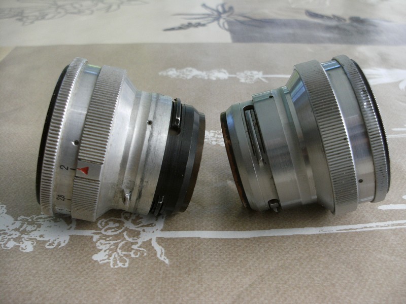

Some remarks about the 2/5cm Sonnars.
After the war, as soon as possible, the Jena factory was put in order to make Sonars again. Two main reasons for that: three cameras needed lenses (Jena Contaxes, Contax IIa and TSVVS): Oberkochen /Stuttgart had problems to produce their own lenses.
The Sonnars on my TSVVS:
On the left, the # 3089522 (on TSVVS # 264), on the right, the # 3090471 (on TSVVS # 503).
Of course, they are not the same: shorter aluminium body for the left one, complete chrome body for the other.
An hypothesis: CZJ could have had some problems with chrome at the beginning. Wartime Sonnar bodies were too made of aluminium. Idem for the first ZK coming from these wartime Sonnars...
A comparison with my two Jena Contaxes:
- Sonnar 2/5cm (short aluminium body)# 3009106 on the Jena Contax # 11826,
- Sonnar 1,5/5cm (long chrome body) # 3089445 on the Jena Contax # 30536.
These "chrome" Sonnars are probably the first real postwar Sonnars.

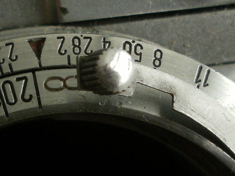

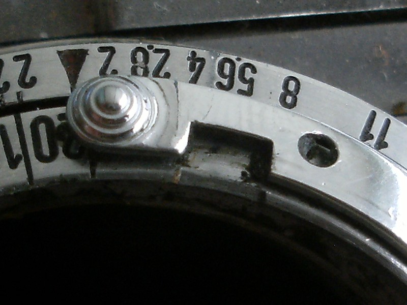

A last post about my own remarks. It concerns the mount of the lens.
A detail of the "stop-lever" of the lens:
The first (upper) one seems to be original. But it is not very strong and can have been replaced by the second one, which is visibly a Contax part.
It is probably a detail, but I saw several TSVVS with that Contax part as a repair.
A general comment: when handling my Jena Contaxes and TSVVS, I am surprised to feel the same sensations. But it is another discussion!
Certainly, you have many comments to add. I hope them!
the lenses are interesting. My TSVVS also has the complete silver Sonnar, my Jena Contax has the black/silver one.
my both lenses are in black/silver (short body): Nr.292 - aluminium und Nr.714 - chrom.
"Stop-lever" of the lens are the same as yours.

I dig out this thread...
About the stop lever of the lens, I have pointed the original one (very thin and weak) which could heve been replaced by the Contax one as repairs.
But it seems that (all? many?) 1950 TSVVS have this Contax stop. So, this stop could be original too...
A reason more to think that there is a close relationship between TSVVS and Contax.
